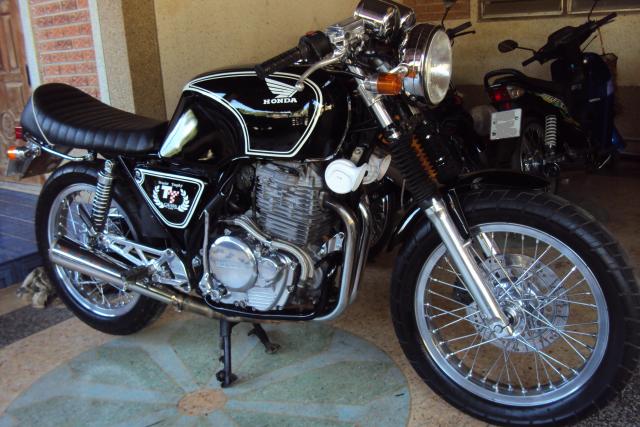

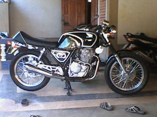

SPEC GB400TT
Car name Honda NC20
Length 2.100m
Width 0.690m
Height 1.060m<1.215m>
Axial distance 1.400m
Form of a motor NC20E
The total displacement volume 0.399L
The kind of fuel Gasoline
Vehicles weight Front pile 81kg <84kg>
Post-pile 87kg
Total 168kg <171kg>
Entrainment capacity Two persons <one person>
Tire Front wheel 90/90-18-51S
Back ring 110/90-18-61S
The minimum ground quantity 0.160m
Braking stop distance 14.0m(50km)
The minimum rotation radius 2.8m
Starting system A self formula, a kick formula
Motor kind Gasoline, four cycles
The number of cylinders, and arrangement Direct 1 horizontal
Combustion room form Hemisphere form
Valve mechanism OHC4 chain drive, the inhalation of air 2, the exhaust gas 2
Diameter [ of inner ] x distance 84.0x72.0mm
Compression Ratio 9.2
Compression pressure 12.5kg/cm2-400rpm
The highest output 34PS/7,500rpm
The maximum torque 3.4kg-m/6,000rpm
Valve opening-and-closing time Inhalation of air It opens. 10 degreeBTDC (at the time of 1mm lift)
Inhalation of air It closes. 30 degreeABDC (at the time of 1mm lift)
Exhaust gas It opens. 40 degreeBBDC (at the time of 1mm lift)
Exhaust gas It closes. 0 degreeATDC (at the time of 1mm lift)
Valve crevice Inhalation of air 0.10mm (between the colds)
Exhaust gas 0.12mm (between the colds)
No-load rotation speed 1,200rpm
Lubricous system Pressure sends type
Oil pump form Truck colloid formula
Oil filtration machine form All flows Filtration types, a filter-paper combined-use formula
Lubricating-oil capacity 2.3L
Cooling system Air cooling
Air cleaner form Screw dregs formula
Fuel tank capacity 17L
Cabreter form V![]()
Gas Valve Path 42mm
The diameter of the ventury 39mm (considerable)
Ignition equipment form CDI formula
Ignition time 8 degreeBTDC/1,200rpm
Ignition plug NGK DP8EA-9,DP9EA-9
ND X24EP-U9,X27EP-U9
Ignition crevice 0.8-0.9mm
Storage-battery capacity 12V-12Ah
Clutch form Wet multi-board coil spring
Operation system Mechanical
Slowdown Ratio from an organization to an in-variable-speed machine 2.482
In-variable-speed machine form Regular engagement formula
Speed change ratio 1 speed 2.384
2 speed 1.555
3 speed 1.200
4 speed 1.000
5 speed 0.875
Slowdown machine First Gear form Chain
Slowdown Ratio 2.785
Front wheel The degree of Caster 29degree25'
Front wheel trail 124mm
Air pressure of a tire Front wheel 2.00kg/cm2
Back ring 2.25kg/cm2
Rudder angle Left-hand side 35 degrees
Right-hand side 35 degrees
Braking equipment form Before oil press type disk
Later Mechanical reading tray ring
Suspension system Front wheel terescopick formula
Back ring Swing arm formula
Frame form Semi double cledor formula
GB400maintenance information
The amount of front fork oil 315+-2.5cc
Slack of a chain It is the central part at the time of center stand use, and is 15-25mm.
Exchange of an air cleaner element Every 20,000km
Exchange of engine oil Every 3,000km
Exchange of an oil cleaner First time 13,000km
Henceforth Every 12,000km
The amount of engine oil 1.6L (at the time of oil exchange)
1.7L (at the time of oil filter exchange)
2.3L (at the time of engine decomposition)
